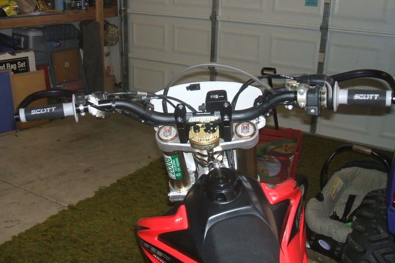

    Here's a pic of my set up:
    38.8 miles, you need to ride more.....

    by Skoot22 » Sun Dec 31, 2006 7:19 pm
    Here is my setup, BRP submount,Scott's, Henery/Reed Pro Tapers
