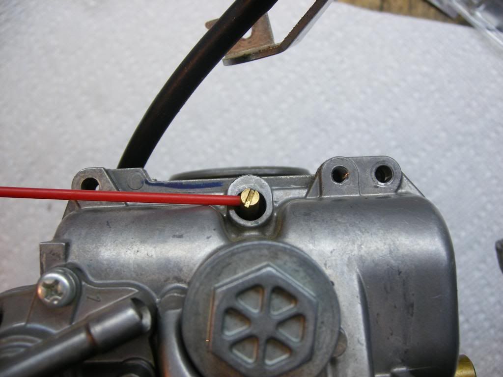

    I need to adjust my factory air fuel screw. Is it as easy as turning the phillips head screw?
    It appears there are 2 screws. Is it the first or second one closet to the out side of the bike.
    2008 crf250x

    The Fuel Screw is located in the front (intake side) center of the float bowl
    Its where his finger is pointing

    Is there a tool I can buy to adjust this?
    I have seen some from Motion pro but I need to make sure I get the correct one.
    Can I adjust this while its on the bike??

    If yours is the Dshaped one , then there is a tool , or you can use a jiffy adjuster by using a RED wire crimp butt connector (for joining 2 wires together) , you just heat it and place it on the screw real quick , then let it sit and cool , it will form the D shape and your done , otherwise , it should be a thin , skinny flat screwdriver
    The aftermarket screws are much easier to use without loosening and tilting the carb for adjustments , i personally like and use on both my bikes , the Flex Jet , it goes near the outside of the carb by your idle screw , and you can reach down and adjust it while your riding , or you can just get any of the extended screws that have knobs on them
    Flex Jet:(i think its the best and easiest to use)
    http://www.crfsonly.com/catalog/product ... ts_id/2792
    D Tool: (not for adjusting while riding)
    http://www.crfsonly.com/catalog/product ... ts_id/3294
    T-Handle type fuel screw: (you can reach under the carb to adjust , but is easier to find when off the bike)
    http://www.crfsonly.com/catalog/product ... ts_id/1333
