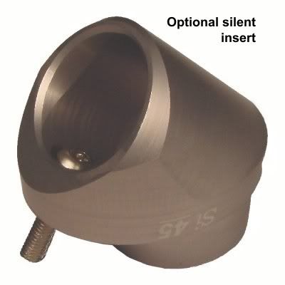

    anyone know about Pro Moto Endo’s Spark Arrestor End Caps?? I thought the extra silencer that came with my 250X was stock.. Apparently I was wrong. It has a Pro Moto Endo’s Spark Arrestor End Cap mounted already. 5'm not sure if the extra 5db spark arrestor/silencer is in it yet because I just googled it. So... any info would be cool!!

    If your end cap is red (new style) the silencer will look like this on the end of it.
    But if the end cap is silver (old style) the silencer will look like this.

    The Hobbit wrote:Thanks, I was wondering if it will be CA. legal and if the performance gains warrant buying the silencer, and rejetting to it???
    It will be CA legal with the endo on no matter what (sparky).
    But the optional silencer piece will make it below 96db (sound legal).
    With the different muffler you should jet it, but whether the silencer piece is in or not will probably
    not affect the bike enough to rejet,
