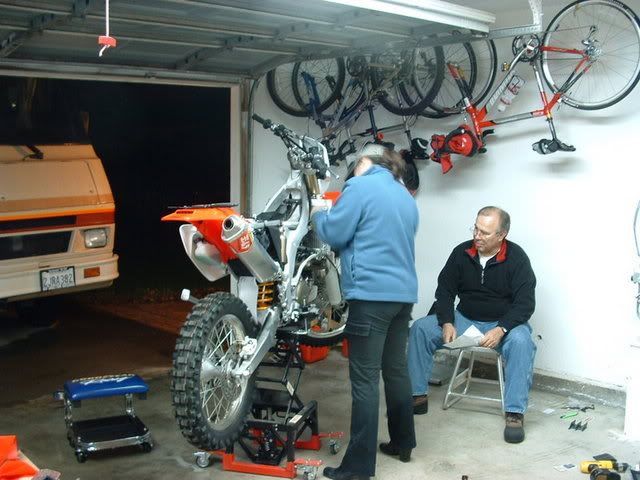

    Well, the new 250x with all of 2 miles on the odo, was partially stripped, upgraded and modified by the new owner!
    My Girlfriend Cristy did all of the mods herself and shot me some really nasty looks when I got too close to the bike or any of the tools she was using. Let me tell you it was really hard not to be able to touch the bike and just observe Cristy having all of the fun! :cry:
    She did an excellent job and I am very proud of her tenacity and mechanical ability. Not to mention she was pounding Silver Bullets as fast as I was! :lol:
    She did all of the work herself with only guidance and tips from me and the occasional extra set of hands.
    We started the process (drinking) :lol: @ 6:30 and were finished by about 10:45.

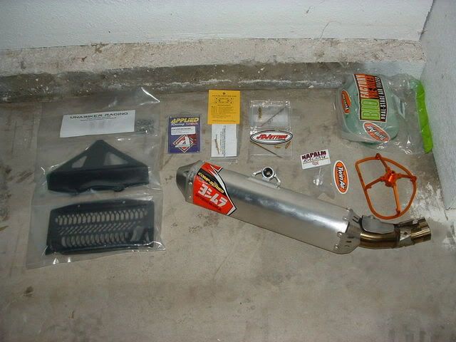

    Jd Jet kit 162 main, Red needle 4th clip position, 42 pilot
    Crf's Only Fuel screw 2 1/4 turns out
    Twin Air with Cage and napalm Screw
    Cut the top off the Air box
    Yoshi slip-on
    Black Unabiker Rad guards
    Smog Block off Kit (smog pump removed)

    Here are the parts laid out ready for install!

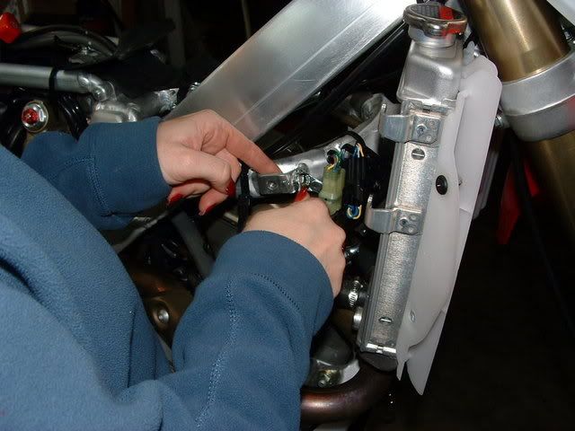

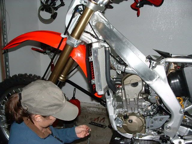

    Cristy getting the jetting issues handled!

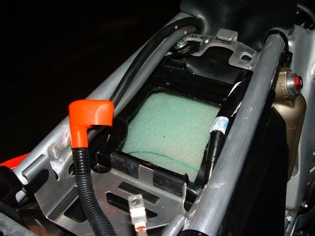

    Cristy's airbox mod.

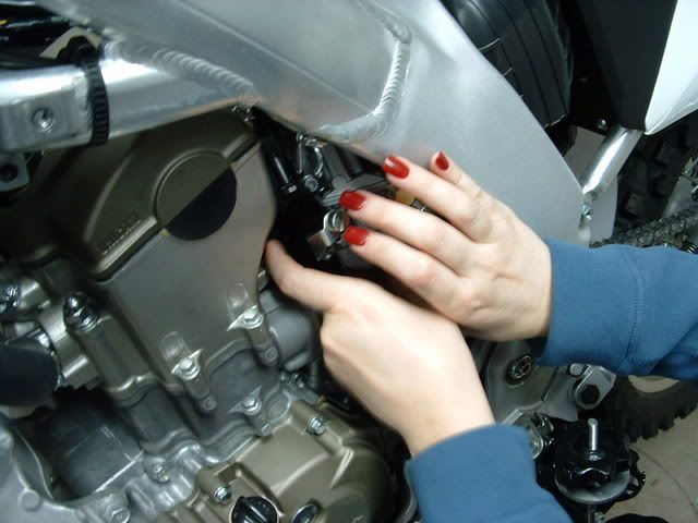

    Cristy doing a custom job on the air pump removal! Rather than cut the wire hanger like the instructions say, she opted to cut the wire hanger away from the bracket where the two were welded together leaving a clean look and the ability to reinstall the pump easily if ever needed.

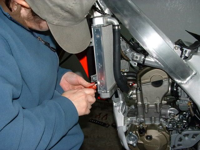

    Well here we are getting the Rad guards in place! I mean here SHE is getting them in place! ;) ;) ;)

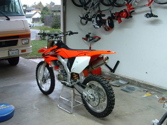

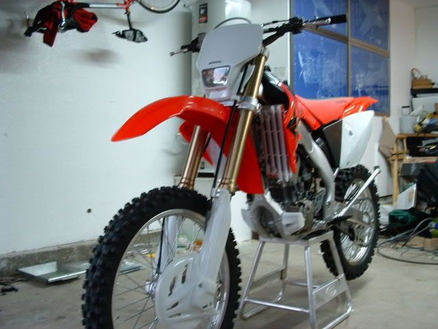

    And a pic of the bike after the mods were complete!
    Took the bike for a quick test last night and again today. Wow what a difference! Great power and I noticed how smooth the whole bike feels throughout the whole powerband.

    i had such difficulty getting the unabikers installed. impressive woman!
