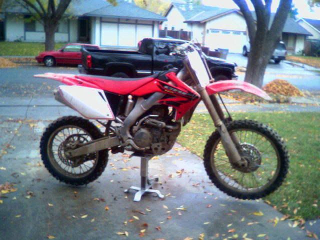

    I have a horrible camera phone picture of my dirty X,
    that has some R parts on it. It has an R tank, faceplate, tripple clamp and exhaust muffler.
    As you can see the brake line goes very high for the headlight.
