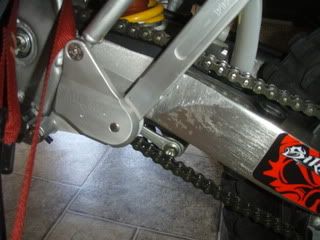

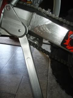

    I have had the 08 150R small wheel since october, I bought the Kickit stand for it shortly afterwards, and it has managed to chew up the side of my swingarm. It has taken a huge chunk out of it, right where the stand slides up to tuck behind the fender. I notified the company and they said they can send me a larger washer but I never bothered giving them my info because I thought I was the only one, and the damage was done. That was until this past weekend when I went riding with my friend whom recently purchased the same bike except big wheel version, also purchased the Kickit stand for it.. I noticed right away that hers was rubbing also, in the exact same way mine began. Anyone have similar problems with the Kickit stand??
    Here are some pics-
    A few weeks ago, I got a little frustrated with the fact that it's still rubbing off metal from my swingarm after the fact that I feel it's already shaven off a pretty deep chunk, so I went out and bought a larger washer for it, yeah it's still rubbing..
    ALSO..
    NO I have never had the kickstand out while trying to start my bike, nothing on the stand is bent, never was, nothing was wrong with my swingarm either before this product. and YES it was installed properly.

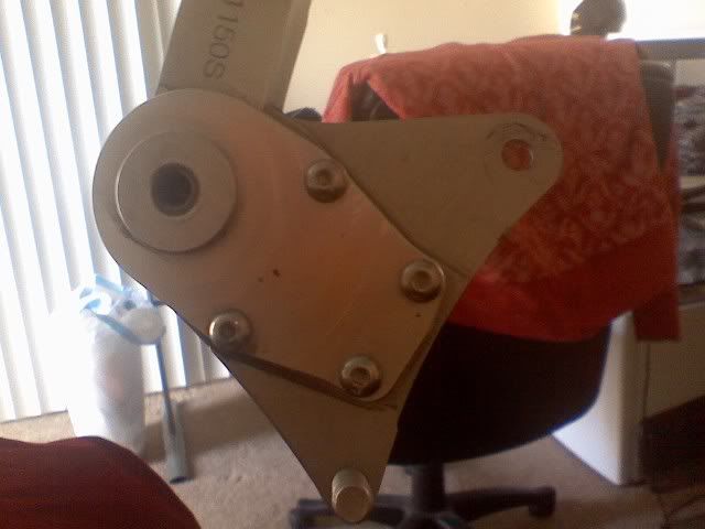

    Back of kickit stand

    FIRST OFF....IF YOU HAVE THIS LEVEL OF INTERFERENCE, PLEASE REMOVE THE STAND AND CONTACT US AT 1-866-466-4762.
    Thank you to Ken for bringing this thread to our attention. I don't think we understood the magnitude of the interference. In the pictures, it does look like the washer is installed between the bottom mount and the kickstand base which would actually move the stand inward and increase the interference. I am not sure who this person spoke with at our shop, but our intent would be to have the user install a spacer in between the frame and the upper mount to move the stand away from the swingarm. Occasionally a customer will have a frame that is slightly different. After seeing the pictures, we have been researching the issue and have found a few more stands that have an interference. We are attempting to determine if there is a difference in swingarms or mounting brackets on various models or years. Occasionally, the manufacturers will make a mid year change to a component. We are not sure this is the case. It would certainly help us if those of you with our kickstand on a 150 would post the year and model of your bike. Is it an 07 or an 08 and is it a big wheel or small wheel and is there a rubbing issue? This will help us narrow it down.
    We are working on a solution for this issue and will respond as soon as we determine the cause and suitable solution.

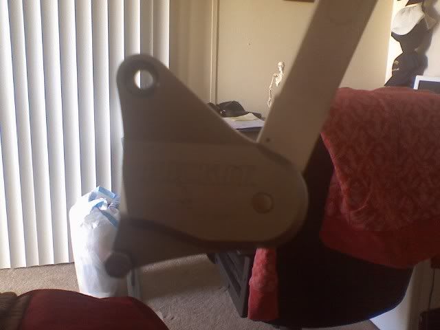

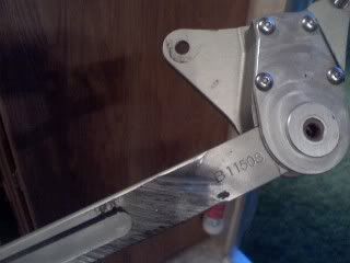

    Okay well, I did remove the Kickit stand about a week ago, here is the most updated photo, I went ahead and added a carbon fiber side guard because I will most likely never be putting this stand back on my bike.
    the front of the stand..
    this shows where the washer was mounted
    the marking from the washer..
    There was no washer placed on the bottom mounting ever. Either way.. I don't believe one tiny washer would have caused this much damage, I know it was not my own negligence, there is a problem with SOME of these stands, I am not saying this is an awful stand, infact I have said that I loved it except for 2 reasons, 1- you have to make sure what type of surface you set your bike on because the stand sits upright too much and can tip over, and 2- the fact that it did cause all this damage to my swingarm.
