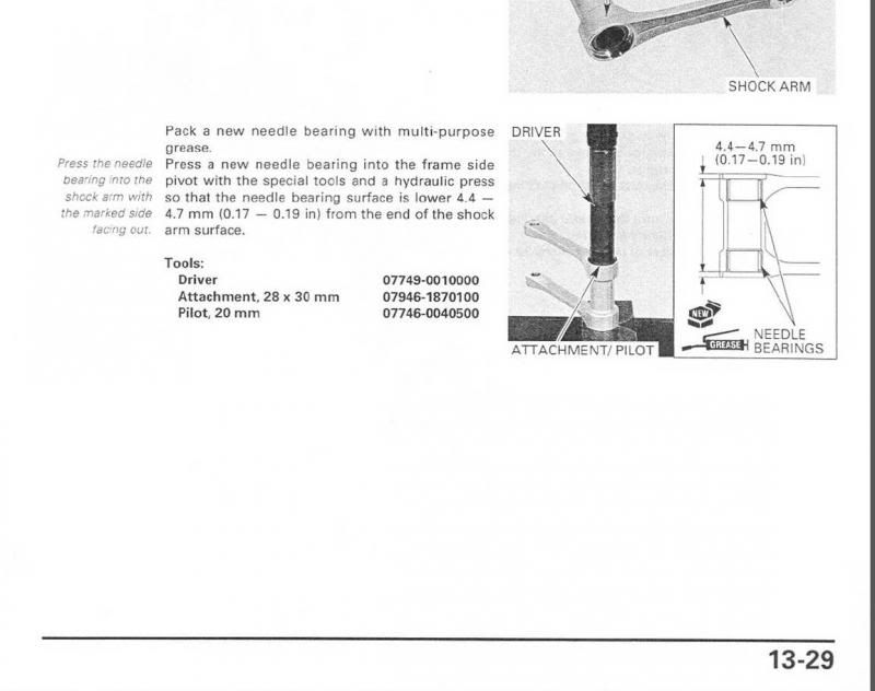

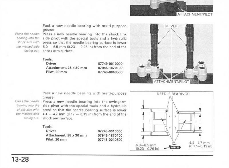

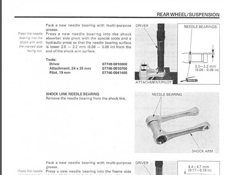

    I recently tore my linkage bearing out of my bike because they were completely trashed. I didn't think to measure how far in the bearing races were recessed into the linkage. Can anyone provide me with this information.
    The bike is an '07 CRF250R
    Thanks
    by 124 » Wed Apr 17, 2013 5:55 am
    This is for a 05 450, but they should be the same (or close).
