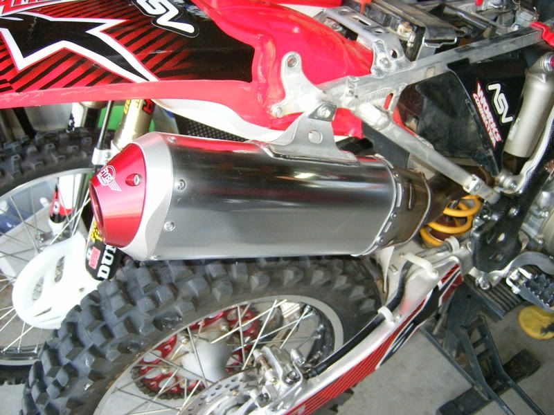

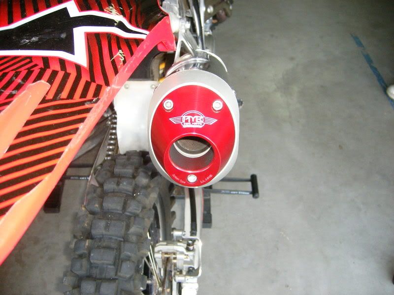

    Here are a couple of pictures of how it turned out. Sorry, bike is still dirty from Sunday at Georgetown. I was slacking on the cleaning when we got home. I will get it all cleaned up today....LOL

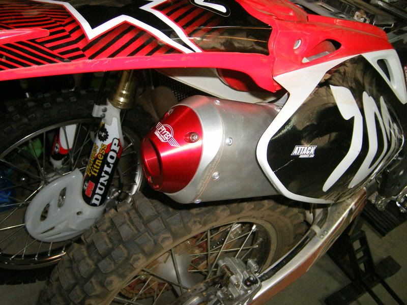

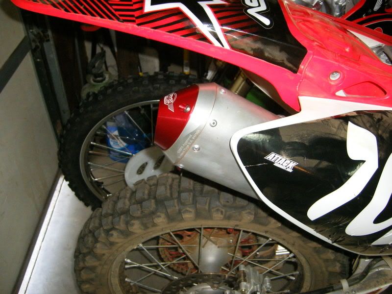

    Here are a couple updated pictures of it completed. I am also in the process of polishing the can but it's not complete yet. :shock:
