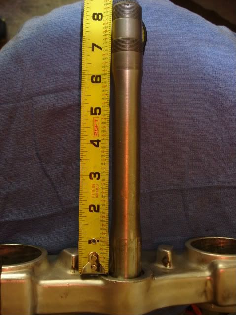

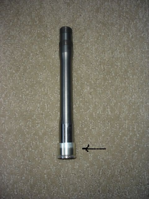

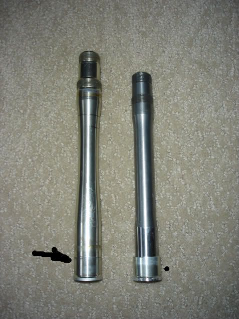

    The 250 triple clamp does not bolt right up. The 250 stem has to be shortened and then new bearing races have to be machined to fit the 230 steer tube. What I did was to remove the 230 stem from the 230 lower triple (it is welded in so you have it machined out or carefully grind down the weld to remove it). I then used a spare 250 stem and made a sleeve. My neighbor has a milling machine and lathe in his garage so the cost to me was nothing. I could not tell you what the cost of having it done by a machine shop would be. I will try to post a couple of pictures of the modified stem. Also if you use the 230 stem you will have to sleeve the upper clamp to fit the smaller diameter 230 stem. The 230 stem, in my mind, was a no brainer. It actually had to be lengthened about 3/8 of an inch to accomodate the thicker 250 lower clamp but that was accomplished with the lower sleeve. An additional beni of using the 230 stem is that you use the OEM 230 bearings and races. There are several guys who have done the conversion over at Thumper Talk using the 250 stem. You might want to do some research over there if you want to go with the 250 stem.

    Well so much for the picture attachment. If you wanna see the pix I guess you'll have to email me. I know I have the technology to perform that task! [email protected]
