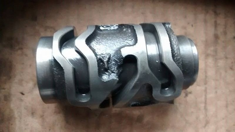

    Some news, i splitted the cases and found the problem. The shifter drum is missing a little of piece (at the side of the Y).
    I will now order the parts and start rebuilding, i will get new 3rd and 5th just to be safe and because this 2005 are prone to get problems.
    The Piston is good so i will just get new rings and a new cam chain.[/img]

    Also , VERY CAREFULLY look over the shift fork , make sure its not also bent , also , search for all the shrapnel , you don't want any cast metal roaming around in the transmission , so make sure you clean every part thoroughly , including flushing out the bearings and spinning them while flushing to "feel" for a debris .... Good Luck !! ;)

    Looks like you found your problem. Try to find the missing piece. Hopefully it is still in one piece.
