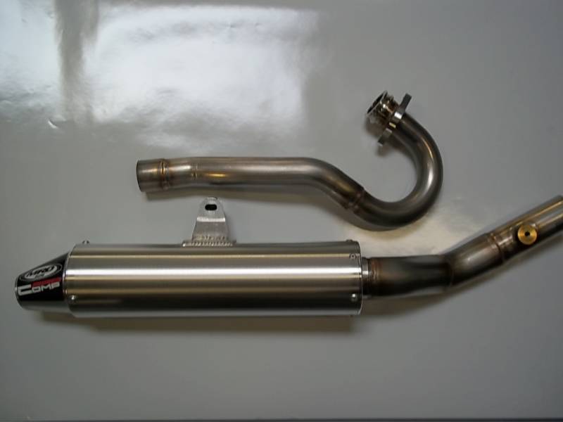

    by Four-Fifty-X » Sun Jan 18, 2015 11:06 am
    Been running one of these for years. Not sure if the owner will sell the header by itself anymore. It's made for the R and is tough as nails...thick, tapered stainless...with an R cam it produces very noticeable differences over stock. Bolted straight on.
    MRD Racing low/mid R header
