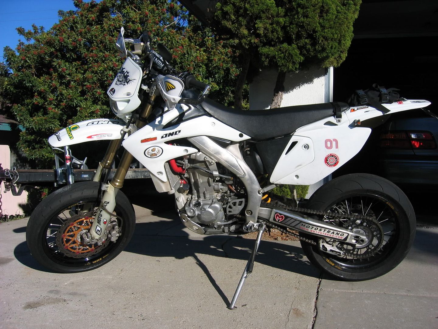

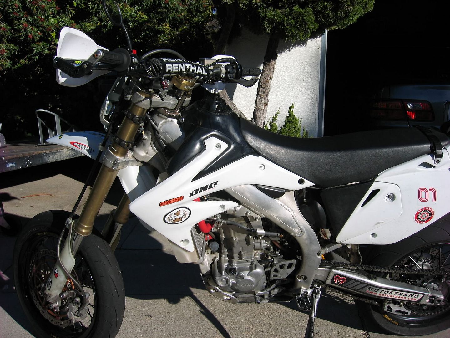

    Hi all, I bought a used tank and I'm not sure what brand it is. It holds a little over 3 gallons and it's black. The question is this:
    the stock gas cap leaks because it bottoms on the tank itself. Are the billet replacement caps shorter so I won't have this bottoming problem
    or do I need to buy the IMS replacement cap (assuming it is an ims)
    thanks for the guidance!

    post up a pic of the tank so we can help ID the brand for you... ;)

    +1 on the pic, but I think that IMS will take the stock cap, where Clarke and maybe Acerbis require vendor specific.

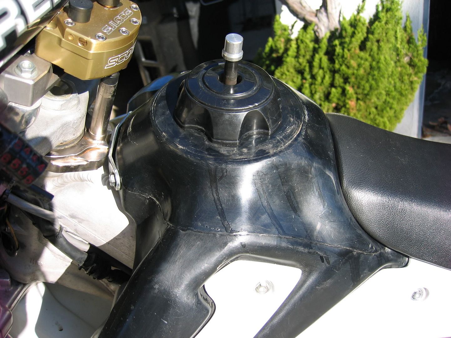

    pics (I hope)
    by Jeff4510 » Sun Nov 28, 2010 9:13 am
    in this last one you can see how the cap bottoms on the tank:
    [/img]
    by Asmith » Sun Nov 28, 2010 9:37 am
    Yup...that's an IMS 3.2 gal tank.

    ~ wrote:Yup...that's an IMS 3.2 gal tank.
    fabulous! So can i use one of the billet caps then or do I have to buy an ims one? this stock one would fit if it wasn't so deep and bottomed.
    by Asmith » Sun Nov 28, 2010 11:32 am
    Gotta be an IMS...but be careful. They just redesigned the cap to a non-leaking unit. Make damn sure it's the most recent cap before you buy it. The 1st and 2nd Generation caps leaked.

    by nminus1 » Sun Nov 28, 2010 3:04 pm
    You need the IMS rubber insert/gasket too

    i have the project 321 cap and have never had any issues. great cap.
    ims hasn't changed their thread/diameter of their caps. however, they did have a bad batch of seals which has been resolved. brp gets their seals from ims and as a result they too had the same problems but they now have the new seals as well.
