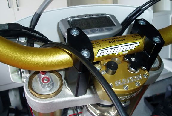

    I'm not seeing it...how does the GPR V4 stabilizer raise the bars 3/4"? Is it simply because the stabilizer comes with taller bar clamps so it can mount underneath the bar?

    by JimDirt » Tue Oct 13, 2015 9:46 pm
    Those look to be about 30mm risers in those pics to allow the stabilizer under the bars

    by mossman77 » Wed Oct 14, 2015 7:05 am
    Okay. I was thinking the stabilizer "kit" came with the appropriate risers. The description on the manufacturer website says that the V4 stabilizer raises the bars about 3/4". I guess it should have said requires the bars to be raised about 3/4". The photo of the V2 is shown with risers, but the V4 photo only shows the damping assembly.
