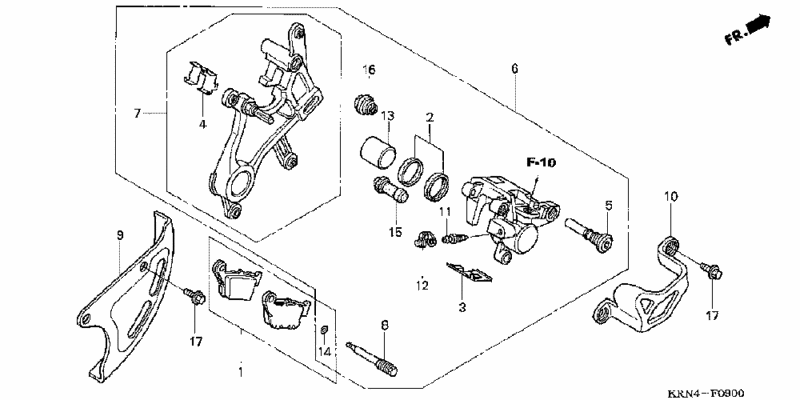

    Sounds like the caliper piston is froze. You'll probably need new piston seals and maybe a new piston. If you can compress the piston enough to get the wheel off, try spraying some penetrating oil around the piston seal. It could be that the seal has gone bad due to it being fully extended for so long. Dirt/crap got in there and froze the thing up.
    A new piston(#13) is $22 and the seals(#2) are $9.
    See below:

    If pulling the cap doesn't work, the other thing I would try would be to release the pressure by loosening the bleed fitting on the caliper (#11?). I had a master cylinder that had the return hole plugged and was having problems with the brakes releasing. I replaced on the pistons, seals, and cleaned everything real good, new fluid, bled a couple bottles of fluid through it and it still would not work. I finally got something small enough to push through the tiny pin hole that lets the fluid return to the master cylinder and that took care of it. But it was quite frustrating.
