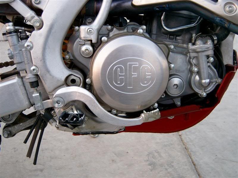

    Here is what I did to mine as a protection:
    I picked it up on ebay and it just get siliconed on your stock cover.
