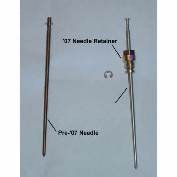

    by crfsonly » Sun Jan 28, 2007 7:18 pm
    just a note to all '07 owners...the needle and retaining screw has been redesigned for '07. the idea is to make the whole assembly, needle and retaining screw, to be removed as a unit. as a result the needle will look different than the one you find in the jd jetting kit. never fear, it is compatible. instead of putting the needle through the retaining screw you put it in the carb first and then the use the retaining screw to hold it in place.

    by crfsonly » Sun Jan 28, 2007 9:05 pm
    BuckNrut wrote:Ken,
    does that mean I don't need the needle holder? Or I have the option of using a needle holder/letting the retaining screw from the jd kit hold it in place?
    Thanks
    not sure what you are calling the needle holder...i have a feeling that it what i'm calling the retaining screw.
    here's a picture that hopefully will help:
    in the '07 design the needle drops down through the retaining screw and then the clip is put on the needle. the top "nail head" of the '07 needle keeps the fuel screw from passing through the retaining screw and the clip keeps it from being pulled up through the retaining screw. to use a pre'07 needle just put the needle in the carb and then screw the retaining screw into the carb to hold the needle in place.
    hope this helps.
    by [email protected] » Sun Jan 28, 2007 9:17 pm
    Kens right, I see what he's talking about .
    The 07 X needle 'holder' is different from the way it was in the 05 and 06 450X. I'd read in the Nov 2006 Dirt Bike that the needle holder (screw top)on the 07X didn't allow clip changes because there was only one clip space on the needle to begin with and that the needle was secured to the now hex shaped screw top.
    So, I guess you CAN use that screw top after all, that's good news.
    That's what I used in my wife's 2007 TRX 450R quad
    I'll bet that's fun to ride Zanardi ! So, the TRX had the same evil one clip needle,huh ?
    If I were to have a quad that'd be the one,that's a whole lot of quad right there. Doug
