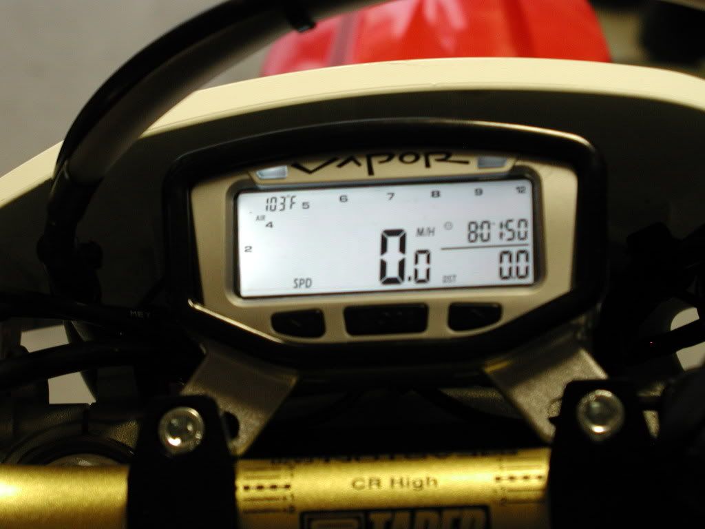

    Does the protector not work with the BRP submount? Width is fine but there is not enough space between the bolt holes of the BRP and the handlebar...it mounts between the BRP base and the caps...right? :?

    Double D wrote:Does the protector not work with the BRP submount? Width is fine but there is not enough space between the bolt holes of the BRP and the handlebar...it mounts between the BRP base and the caps...right? :?
    Double D
    The spacing was also incorrect on my Lynx protector to work with my BRP submount. I elongated the bolt holes on the protector and it worked fine.

    by Double D » Sun Jan 14, 2007 10:50 am
    Interesting...
    It looks like the only way my Vapor protector would work is if I milled off the mounting tabs where they meet the bars. This would open the holes and the mount would only be secured by the pinch force of the bar caps and base.
    I'll get in touch with Ken Monday or Tuesday and see what's up.
    Thanks!
    by Ernie Pezz » Sun Jan 14, 2007 11:03 am
    Double D wrote:Interesting...
    Thanks!
    That's exactly what you do.

    by 1fordman » Sun Jan 14, 2007 6:58 pm
    I have the gpr v2 posted a post (no response) i went down to the local hardware store got 1/2 inch longer bolts put the mount on top some major trimming of the bar pad(1 1/8 ) but mounts higher and bars are tight vapor looks good
