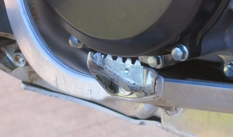

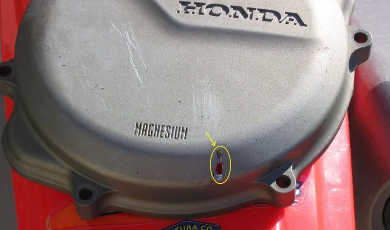

    Last week I had a pretty mild fall to the right side of the bike during a GP in CalCity. Luckily for my bike, I twisted my knee and spent a little time "walking it off". During that time I discovered oil leaking at a fast drip from the clutch cover. It turns out that the rear brake pedal flexed enough to punch a small hole in the cover. Had I not twisted my knee, I would have jumped back on and rode until the oil was gone and the tranny seized.
    Ironically, when I bought my bike, the salesman told me it would be a good idea to file off a couple of teeth from the brake pedal to keep this from happening. Having no "bling" factor and being inherently lazy, I pretty much disregarded this good advice.

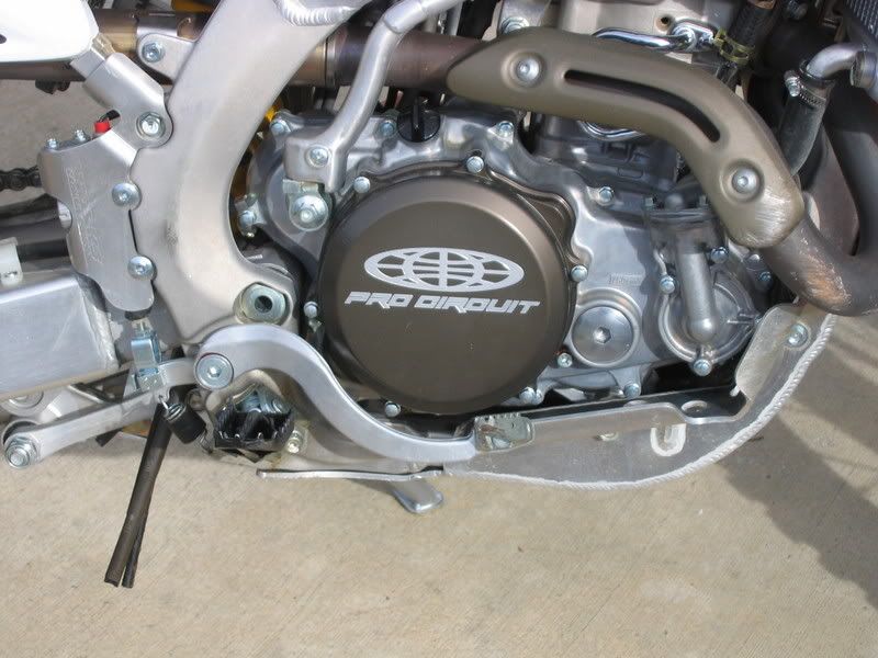

    I am now sporting the ProCircuit billet aluminum clutch cover and have filed off a total of four teeth (two in front and two in back) from the brake pedal.
    At the very least, I would suggest a quick visual inspection of the clutch cover every time your bike goes down on the right side.
