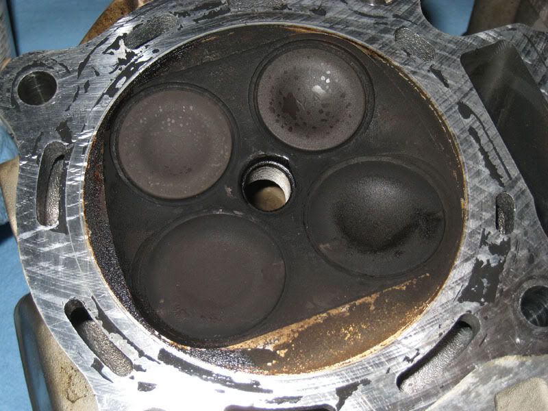

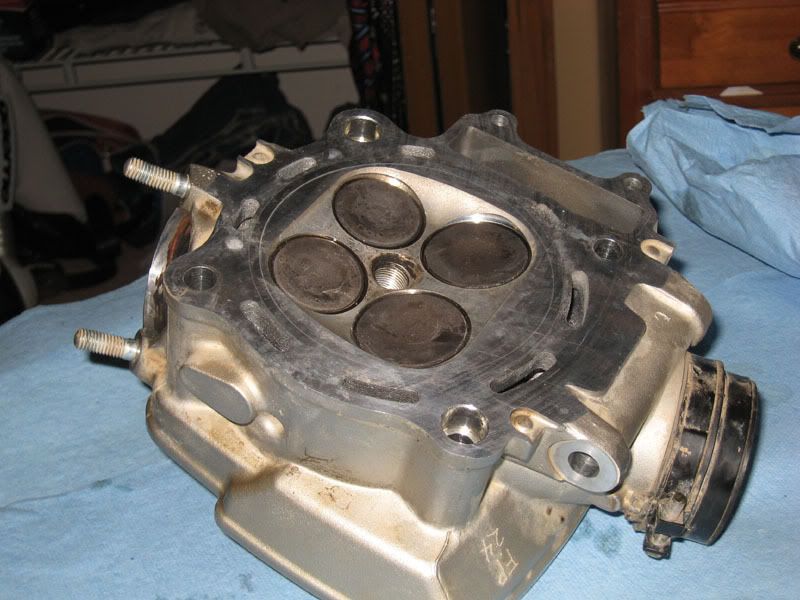

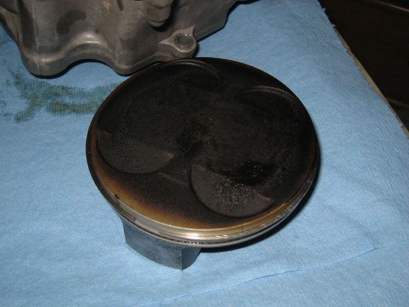

    Ok I just thought I should post how this all turned out for me. When I pulled the head and piston I found this:
    I emailed JD and he suggested that it was likely my idle circuit which was to blame for the rich condition. He asked me to try out:
    #162 Main (down from a #168)
    #42 Pilot (down from the stock #45)
    Red needle, 4th position from top
    Fuel screw 1 1/2 turns out
    I also took this opportunity to do the O-ring mod provided with my JD kit since I had the carb off.

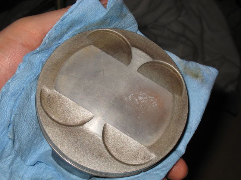

    I cleaned up the head and piston, they looked pretty good upon installation:

    I am going to get greif for this, but you my friend have an oil control problem. Look at a few things. Number one. The threads on the plug. Normally this is one of the elements for tunning a alcohol enging, but for a gas motor, anything but ani seize is a bad thing. When you put a new plug in it, a lean rich adjustment should be made by the where the mixture ring is not the appearance of a wet plug. In my experience, a plug that is fouled that badly and the bike runs great shows the presence of a oil fouling not gas foul. I am not saying that it is not rich, but dial it in after you put a new plug in and ride it as you normally do, shut it off, then do a plug check.
    Your piston shows signs of deonation. Specifically on the right side. You can see it wspecially when you cleaned it. If that is pitting and discoloration after cleaning, it has been detonating.
