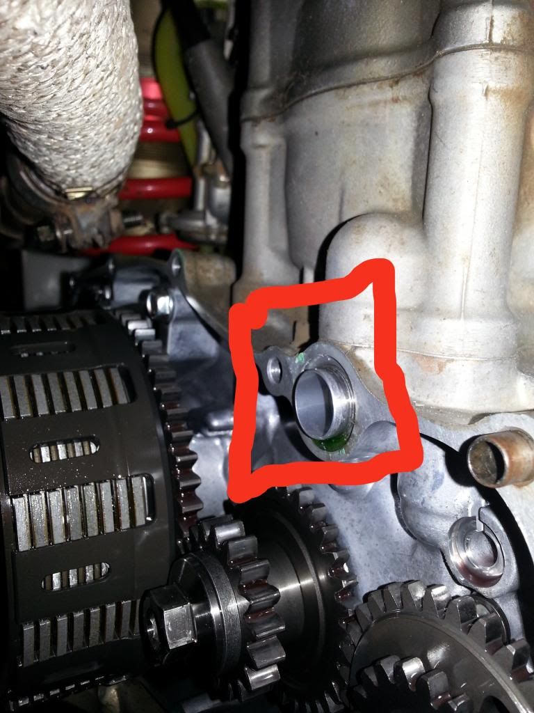

    so ive got a 06 crf250r that im replacing the water seal because my weep hole was leaking coolant. ive got two questions hoping i can get some help with.
    1) when i took the right case cover off a washer fell off and i dont know what it goes to, its about the size of a quarter. i THINK it goes on the kick start shaft. i have a picture[img][img]http://i934.photobucket.com/albums/ad189/Leirhiht/20130728_220335_zps7104e3fb.jpg[/img]
    2) the coolant bypass pipe on the casing is kinda of bent and i want to replace it. the service manual says to take it out but it is stuck in the casing good. is there a special trick to removing it or just use some pliers and yank it out? [/img]Image

    correct on the washer.

    try some low heat with a good set of pliers as u are replacing it anyways.
    what type of oil were u running on the clutch side with that color?

    gmgearhead wrote:try some low heat with a good set of pliers as u are replacing it anyways.
    I use Honda trans fluid...why do you ask?

    by gmgearhead » Wed Jun 25, 2014 3:00 am
    i asked because i haven't seen that type of color fluid. how do u like it? how did u make out with that coolant tube?
