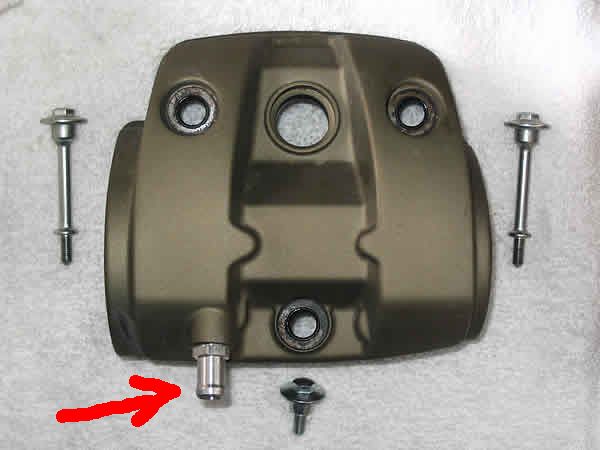

    On a different note can this breather tube/nipple be purchased by itself that you know of? The head I bought used cam with the rocker cover but was missing this piece and I am having a tough time finding another.
    by crfsonly » Sun Mar 01, 2015 2:36 pm
    Unfortunately, it is not available separately from Honda.
    Ken
  • EKhatch
    Posts:84
    Joined:Fri Mar 04, 2011 9:18 pm
    by EKhatch » Sun Mar 01, 2015 3:11 pm
    Okay, thanks. I'll hit up the local plumbing specialty store.
