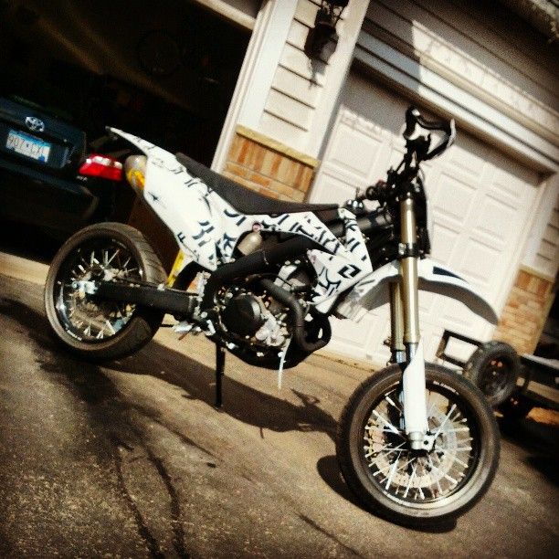

    by SilentAnarchy » Tue Apr 29, 2014 7:20 am
    I turned my 2011 450R into a street legal machine. It has an upgraded trail tech stator, Trail tech battery pack, a wiring harness from Vancouver SM, and currently running a KTM EXC headlight.
    Not the clearest picture, but its the best side shot I have.
