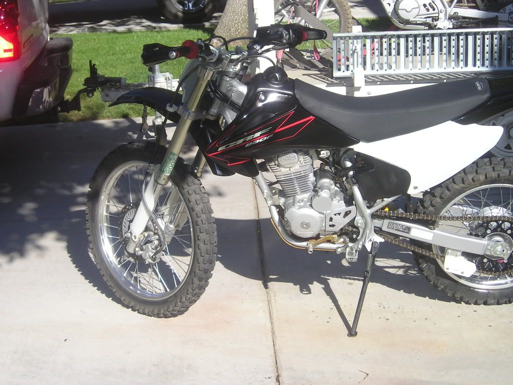

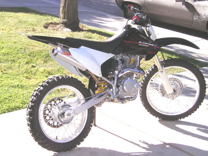

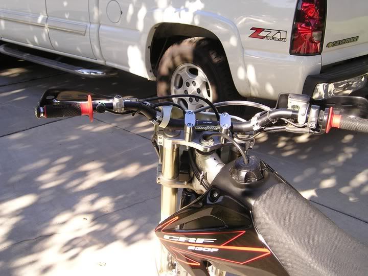

    Here's a few pics of the CRF230F we built with inverted Showas. I think we had about $400-$500 into the conversion when all was said and done.
