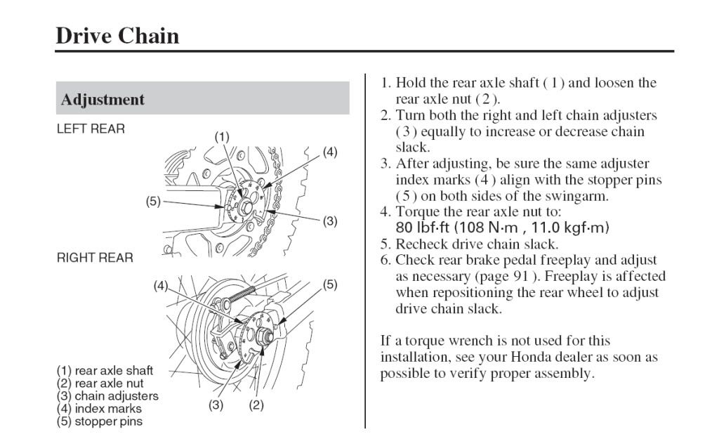

    by Raymond » Wed Sep 02, 2009 8:39 am
    ~ wrote:Image
    Thank you so much very helpful on the chain side it was way out of adjustment. I am brand new to this forum and love it already!

    You can't tighten the chain but you can move the rear axle.
