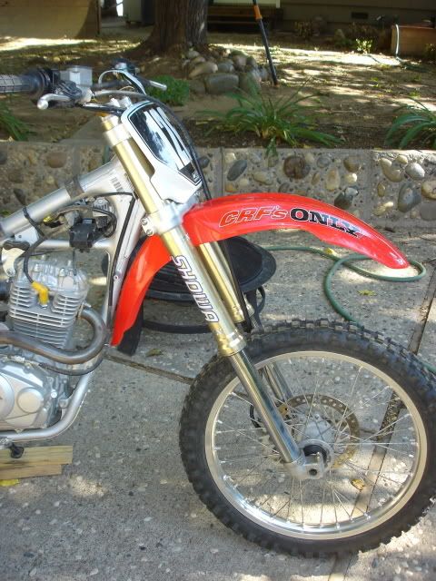

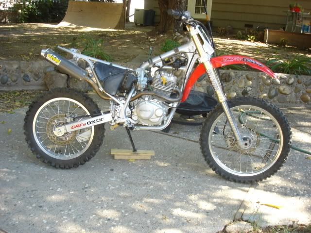

    If you have the option of the 125 forks go with it. The conventional 85 forks although a probable up grade to the 230 forks would not be as much improvement as the 125 forks. The 125 forks are more appropriately sized for the weight of the 230. Will get you a link to the 125 conversion when the web site wherein it is posted, quits acting up. Here's my project 230.
    CR250 forks CRF250X rear wheel and disc brake.
    Can't wait to finish it up and recover enough from knee surgery to ride.

    Went the spring route and fiddled with oil wt and height. Put on a fork brace and BBR upper triple clamp. All of which, as indicated, took just a few minutes time and in comparison was relatively inexpensive. Improved? Yes but still, in my opinion, under suspended. Considered the CR85 conversion but after much research opted for the 250 conversion.

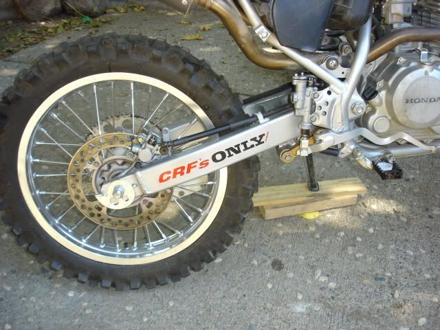

    1. Are the blocks under the stand because the bike is now higher or just uneven ground.
    2. Can you give us a bit more on the rear brake/wheel swap.
    Thanks

    The bike does, in fact, sit higher. The stance was raised significantly when I added the Works Performance shock and BBR shock linkage. It still supported ok without the wood blocks but out on the trail it leans over severely. I am going to have to lengthen the kick stand to compensate.
    BTW since I did my front conversion Emig Racing has developed a stem for the 230 that presses directly into the 250/450 up side down triple clamps. Check it out!
    PM me with an email address and I will send you my HOW TO on the disc conversion (step by step with pictures)
