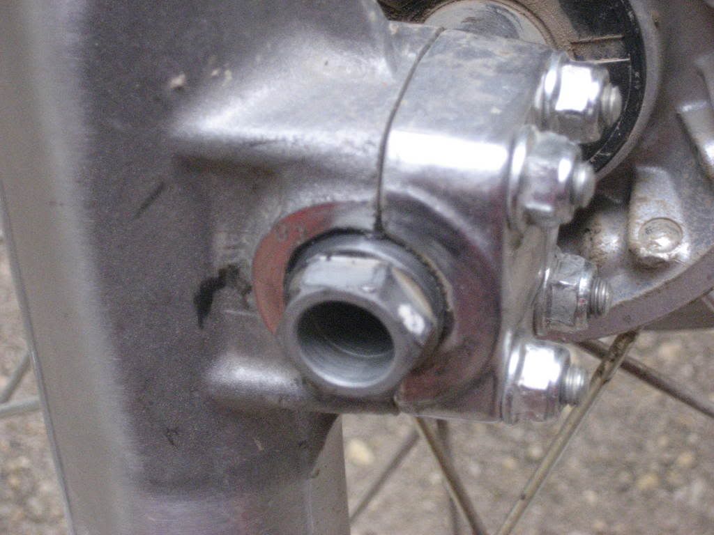

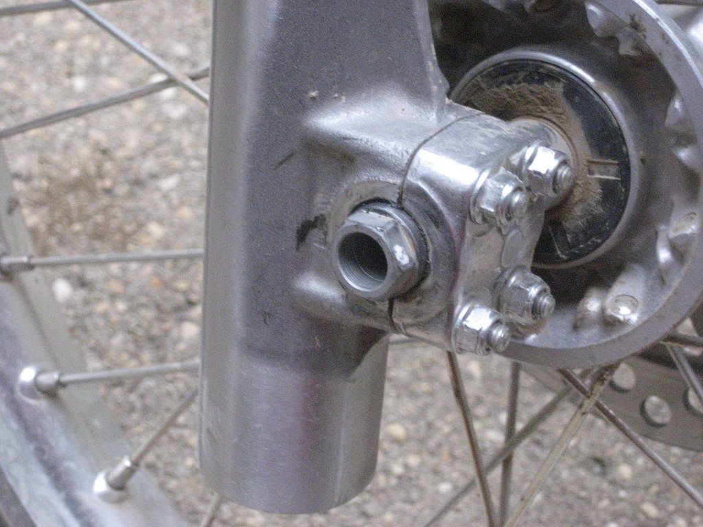

    Just got home from riding.. i rode MX track all day.. and wow was it tough.. i stopped to take a break and noticed my front wheel was incredibly loose... so loose i could turn the bolts by hand.. i tightened them up but to me it looks like im missing something... am i or am i wrong? is there something that should prevent the wheel from sliding off besides those 4 bolts?

    A washer maybe?

    and something that would hold the washer on? that thing that looks like its cornered like a nut isnt a nut... if i loosen those 4 bolts i can slide the wheel right over it

    Nothing missing, the four nuts are used to pinch the axle in place.

    thanks randman... im actually shocked they came as loose as they did.. they where all on the verge of falling off

    What out tightening those bolts back, they only need 9 LBS.
    by Aussiecrf230 » Mon Nov 05, 2007 1:01 am
    If the axle is loose here or there are metal fragments, then you may have killed a wheel bearing.
    No way they should come loose.
