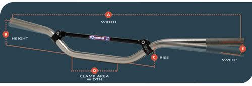

    Sometimes I think I am dumb and do not understand a thing about bikes; and guess what I have another topic that confuses me...
    What are the three measurements used to describe the bend in a bar actually mean. And more particular, what is the difference between a CR High and CR Low bend?
    by 124 » Wed Oct 24, 2007 8:06 am
    CR HIGH
    WIDTH: 810 mm
    HIEGHT: 90 mm
    RISE: 71.6 mm
    SWEEP: 68.5 mm
    CR LOW
    WIDTH: 800 mm
    HIEGHT: 70 mm
    RISE: 51.5 mm
    SWEEP: 58 mm
    Pulled specs randomly, some brands may vary slightly..
