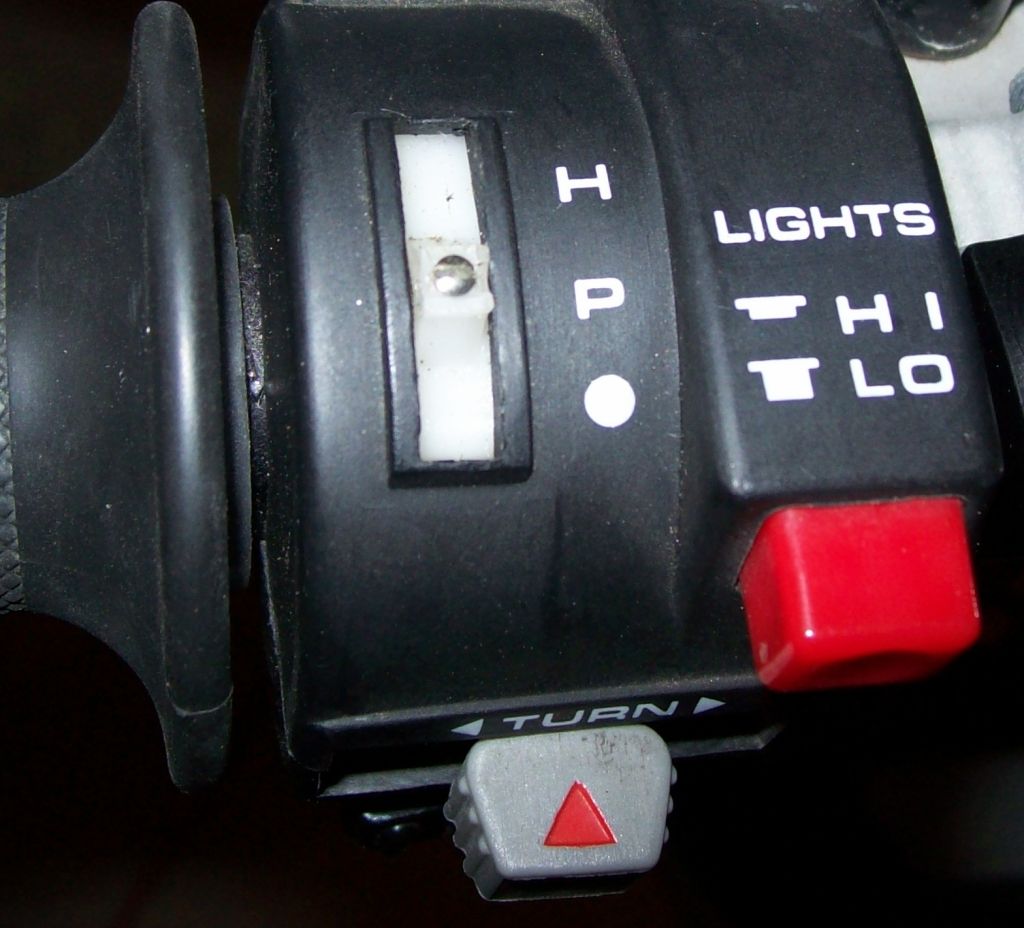

    The Baja Designs kit will get the job done however there are some points I need to make. First the kit did not include a front brake tail light switch (required in Texas); I had to order that separately.
    I park my bike in a garage & yet after a year I started having problems with the plastic BD is using. First I had problems where I mounted the tail light assembly to the rear fender. The plastic used in the BD tail light assembly will crack under stress. I had to repair mine by reinforcing it with aluminum bar stock and JB Weld.
    I also had the power/light switch brake where the weather cover snaps to the switch. I emailed BD asking them if they have started using better parts and if they had replacements but I got no response.
    I had to put a micro screw in the switch so I can operate it. When I do replace the switch it will not be a BD product.

    Standard warranties are generally only a year long, I know this kit is outside that time frame. However I would definitely appreciate any assistance obtaining a new part.
    I doubt BD will ship the subassembly part that is actually broken. Standard procedure in cases like this would be to replace the entire switch assembly.
    The part that broke is the slide for the OFF/Park/High. Pictured above, The white plastic part that I drilled and inserted the screw into so I can still use the switch. The part of it that broke is the two clips that hold the thumb knob/weather cover.
    Here is a photo of a complete assembly.
    I am not looking to replace the taillight assembly; it will never be a problem now.
    Regardless of the outcome…Thanks!

    Replacement parts arrived today!
    The swap out only took ten minutes and because the part was of the same design I used JB Weld to hopefully give it more strength. I also lubricated the action. Looks new and works great.
    Thank You Ken!
