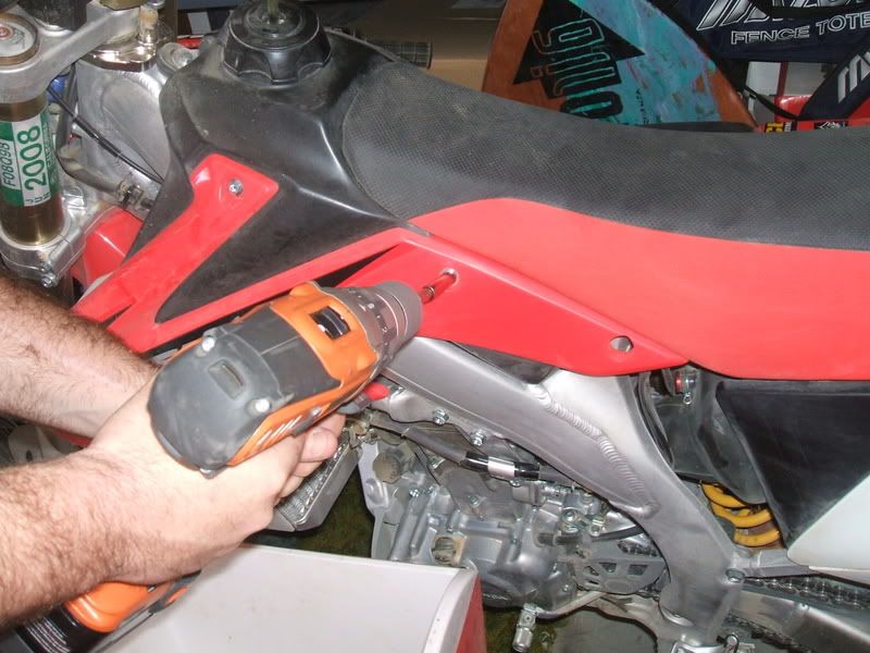

    This seems to be common Problem with the X's

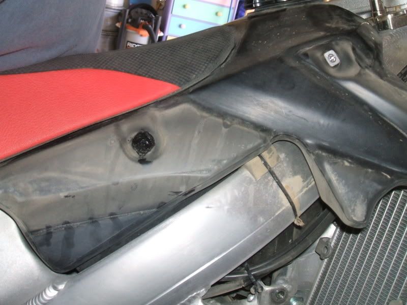

    First i took the others out , then i got the 1 that was stuck moving with a ratchet, then i put a drill on it.Started in torque mode then to high speed.
    As you can see it melted the plastic and slid right out.

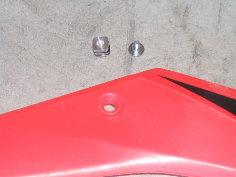

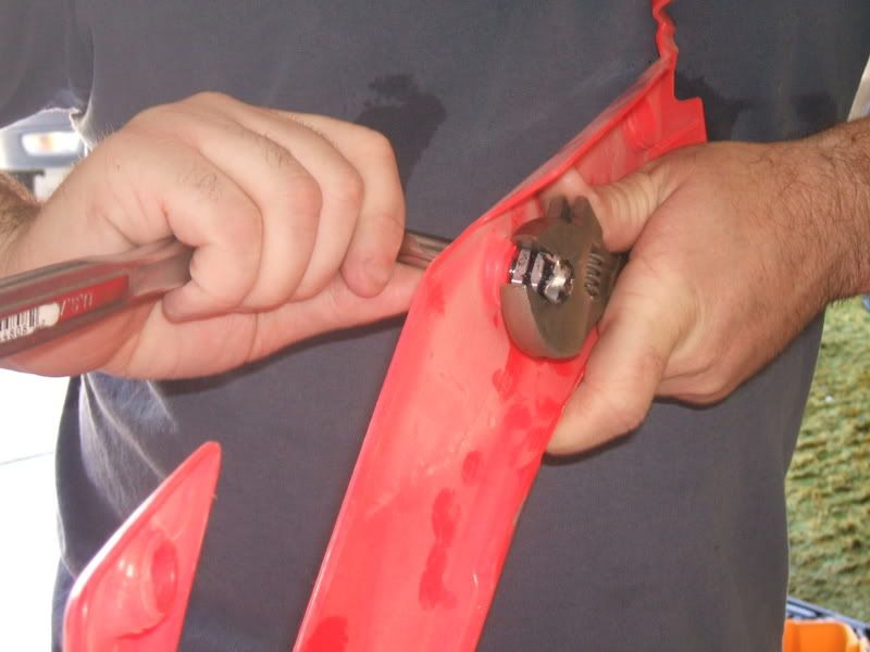

    Now with it off i took a cresent and an 8mm ratchet and broke the Barrel nut loose from the bolt.
    As you can see no Damage to the shroud.

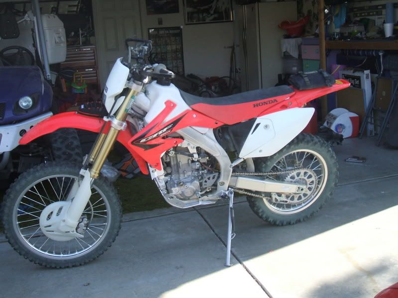

    All done and back on the bike with new tank.
